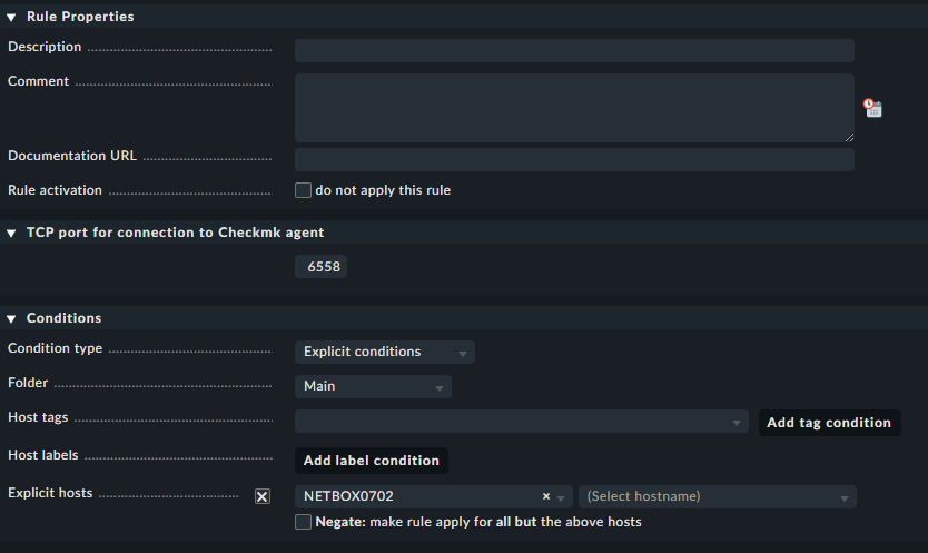

      Create a rule for the Agent within the CheckMK Webview:
      Setup > Agents > Access to agents > TCP port for connection to Checkmk agent
      Example rule:
